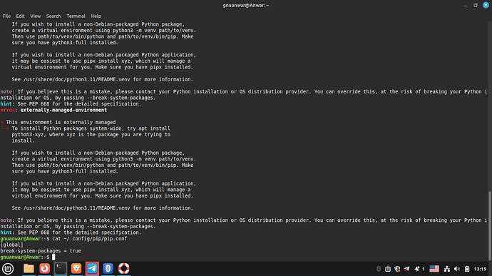

ima trying install pdf to text in my lenova x230 os linux mint lmde faya 6
fro this url GitHub - KaniyamFoundation/Pdf2Text: Project to convert PDF files to Text files using google OCR
sudo apt-get install poppler-utils mupdf-tools git python3-pip ghostscript qpdf
sudo pip3 install requests --ignore-installed
sudo pip3 install configparser --ignore-installed
sudo pip3 install google-api-python-client --ignore-installed
sudo pip3 install oauth2client --ignore-installed
sudo pip3 install telegram-send
the error is
note: If you believe this is a mistake, please contact your Python installation or OS distribution provider. You can override this, at the risk of breaking your Python installation or OS, by passing --break-system-packages.
hint: See PEP 668 for the detailed specification.
error: externally-managed-environment
× This environment is externally managed
╰─> To install Python packages system-wide, try apt install
python3-xyz, where xyz is the package you are trying to
install.
If you wish to install a non-Debian-packaged Python package,
create a virtual environment using python3 -m venv path/to/venv.
Then use path/to/venv/bin/python and path/to/venv/bin/pip. Make
sure you have python3-full installed.
If you wish to install a non-Debian packaged Python application,
it may be easiest to use pipx install xyz, which will manage a
virtual environment for you. Make sure you have pipx installed.
See /usr/share/doc/python3.11/README.venv for more information.
install.
install.
install.

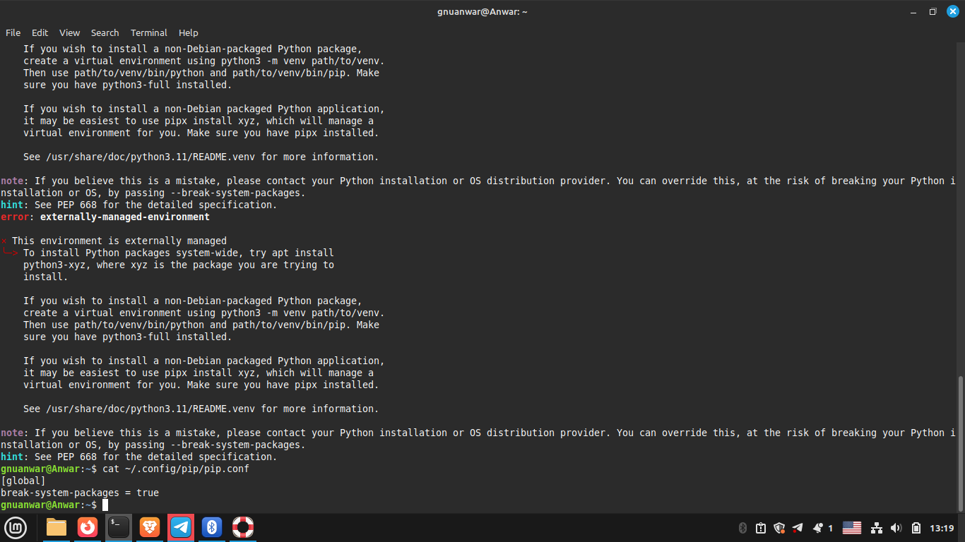

how to solve
Create or edit ~/.config/pip/pip.conf with the below text
[global]
break-system-packages = true
and then run the same commands again.
install.
install.
install.
again same error
